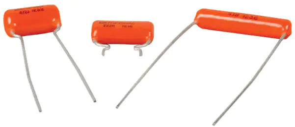

capacitors: min voltage rating for tweet HP filters, and thoughts on alum foil orange drop caps
edited March 21 in DIY
More than likely the min voltage question has been posted- sorry I didn't see it. I do see Mouser offers orange drops caps in both 100v and 200v, with the 100v versions in .82uF and 1uF capacitance. The 200v max is .68uF.
I'm a bit curious biz tube amp aficionados seem to be smitten, but it may be because they impart a tone, or are they just really good? Paralleling could get to very close matching tolerances, and they are alum foil design (and, I understand that even in parallel I should just look at the voltage of one capacitor). I haven't seen anyone use these in their tw HP filters, so that may be my answer in and of itself, but I thought I'd ask. -thanks

  • Most Orange drops are 600V

    Probably the very small values- I ran for the larger ones - as for a 3rd order I’d be looking at 1.9 to 2.2uF for C1, and 6 to 6.8uF for C2 (and that may be paralleling 6 to 10 caps on the top end).

    People like Orange Drop capacitors because of the placebo effect.
    https://mouser.com/applications/audio-gibson-orange-drops/

  • I used some Orange Drops as coupling caps in a tube amp. Switched them out in favor of some Audyn Q4's. The Audyns where sonically better IMHO. But these were small values, like 0.22 uF or 0.33 uF IIRC.

  • One way to find out I guess. I currently have a celestion coax with a hp using Jantzen Silvers, so I can just order a bunch of O Drops and duplicate the filter and measure and listen. Probably going with the 200v 715p or 716p.
  • Additional question: When looking at PIO caps, metalized vs foil (the metalized are 250v, the foils 200v, which I do not think should make much of a difference for tw HP).
