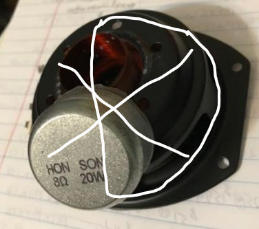

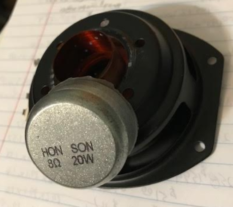

This is a long shot ... someone at work tossed this Milwaukee portable radio into the rubbish bin. Both woofers have the magnet broken off and the voice coil damaged. Oddly enough, the magnet appears to be held onto the basket with only glue. Only id I can find on the woofer is Hon Son 8ohm 20w. It has an odd oval shape and the mounting holes are not evenly spaced around the basket rim. The amp uses a tas5766m purepath chip, which looks to be fairly decent.
Since we like to fix audio stuff here, I wonder if anyone knows of a replacement woofer, or a good place to start looking? So far I can find nothing on the net about a replacement and as of yet, no luck on aliexpress.

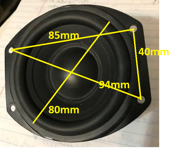

    Ha, the sds magnet won't even fit in the space behind the woofer. Hard part is going to be matching the mounting hole spacing as there is no other place for a screw to go and it's odd spacing really narrows the choices to zero.

  • The ND91 frame looks like the closest fit. to match the original mounting I would cut the original frame to make a mounting ring to go over the ND91and modify the ND91 if needed.
  • You may be on to something there. Worse comes to worse, I'll see if boy can draw and print some kind of adapter. Still leaves me with the unknown t/s of the oem woofer, but these things don't sound that great to start with.

  • glue the magnet back on. I did that with the Aura ND-90 look alike and it was fine.
     John H, btw forum has decided I don't get emails
  • Voice coils are damaged and stick the cone in place. Don't think it's something fixable, but might give it a go.
